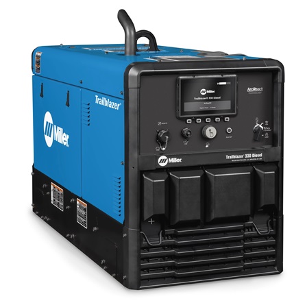

Trailblazer® 330 Diesel | MillerWelds
Trailblazer® 330 Diesel (Kubota) w/Excel™ Power
907849001
Reliable engine-driven welders with unbeatable arc performance, providing the smoothest, most stable arc in the industry.

Auto-Speed™ technology
Separate weld and auxiliary power
ArcReach® Technology
ArcReach technology uses existing weld cables to communicate process adjustment commands back to the engine-driven welder. With an ArcReach system, amperage & voltage are conveniently located at the operator's fingertips - not back at the power source.   Learn More
Dynamic DIG™
Unlike conventional DIG that provides a preset amount of short-clearing current, Miller’s proprietary Dynamic DIG works on a time-based algorithm that automatically adjusts the amount of current required to clear a short. What does this mean? A smoother more consistent arc that can be tailored to match application, material, fit-up, and welder technique.   Learn More
QuietPulse™
QuietPulse is activated by changing the waveshape for DC pulse welding, creating a slower, more fluid transition between the background and peak amperage to create the least possible audible noise.   Learn More
Excel™ power (option)
Power at idle — a Miller exclusive. Unlike competitive machines that provide auxiliary power only at 3,600 rpm (max), Excel power delivers a full 2,400 watts (20 A) of 120-volt inverter-based, pure sine wave power at all speeds, including idle. With Excel power you can operate jobsite tools like grinders at quiet, fuel-saving speeds. Refueling time and operating costs are reduced with Excel power, which means more productivity and profitability. Plus everyone on the jobsite gets a better working environment because noise levels and exhaust emissions are lowered. Excel power — available only from Miller.   Learn More

General Specifications
Title Trailblazer® 330 Diesel (Kubota) w/Excel™ Power
Industries Interests Construction and Fabrication
Heavy Equipment
Railcar
Amperage 20 A - 330 A
Weldable Metals Aluminum
Stainless Steel
Steel
Rated Carbon Diameter 1/4 in (6.4 mm)
Current Type DC
Max Open Circuit Voltage 107 VDC
Portability Lift Eye (Standard)
Running Gear / Cart (Optional)
Trailer (Optional)
Cold Weather Starting Aids Glow Plugs
Engine Brand Kubota
Engine Compliance T4F
Engine Idle Speed 1800 RPM
Engine Weld Speed Advanced Auto-Speed(TM) technology: Varies engine speed from 1,800-3,600 rpm to match weld output
Fuel Tank Size 11 Gallon
Fuel Type Diesel
Horsepower 24.8 hp
Weld Output CC/CV
Rated Output CC/DC Stick/TIG 330 A at 31 V, 100% duty cycle, CV/DC MIG/FCAW 330 A at 3.25 V, 100% duty cycle
Single Phase Auxiliary Continuous Power 10500 W
Single Phase Auxiliary Peak Power 12000 W
Sound Rating 74.7 dB @ idle and 80.2 dB @ max weld
Applications Aluminum Welding
Fabrication
Field Welding
Industrial Welding
Mobile Fabrication & MRO
Structural Welding
Warranty 3 Years
