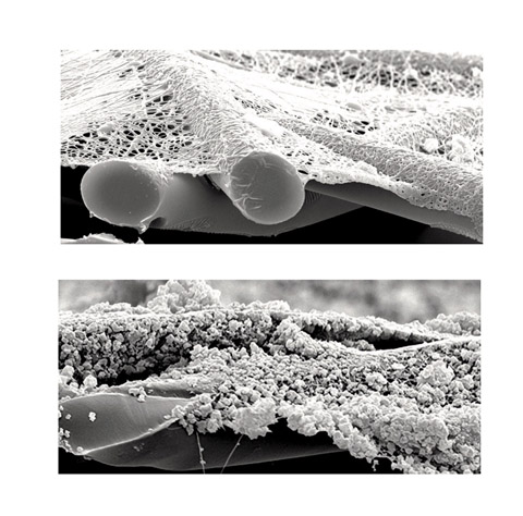

Nanofiber filters
Filters that utilize nanofiber technology have a very thin surface layer that offers high efficiency in filtering the smallest of weld fume particles. This thin layer also offers low-pressure resistance to airflow, which allows the high fume capture efficiency to be maintained for a longer period of time.
Some filters have a thicker surface treatment, which can provide high fume capture efficiency but also has much more resistance to airflow. As soon as these types of filters begin loading, the airflow measurement in cubic feet per minute (cfm) starts to drop significantly.
In addition, nanofiber filters are surface loading, versus depth loading. This means the nanofiber captures particles on the surface so weld fume accumulates on the top of the filter without penetrating into the media itself. This allows for the particles to be released much easier during the cleaning process, which is often done internally via a self-cleaning process in the fume extraction system with compressed air.
Surface-loading nanofiber filters, like those in the Miller FilTek™ XL filter series, provide high-efficiency cleaning and also offer high loading for longer filter life and the least amount of resistance to airflow. FilTek surface-loading filters hold up to six times more dust given the same pressure drop across the filter media, compared to common cellulose filters. This results in a high level of fume capture at the source, for optimal breathing zone protection.
Depth-loading filters have high restrictions to airflow, reducing system performance versus FilTek XL filters. Using filters designed specifically to capture welding particulates increases both effectiveness and efficiency in removing welding fume particulates from the welding environment.
