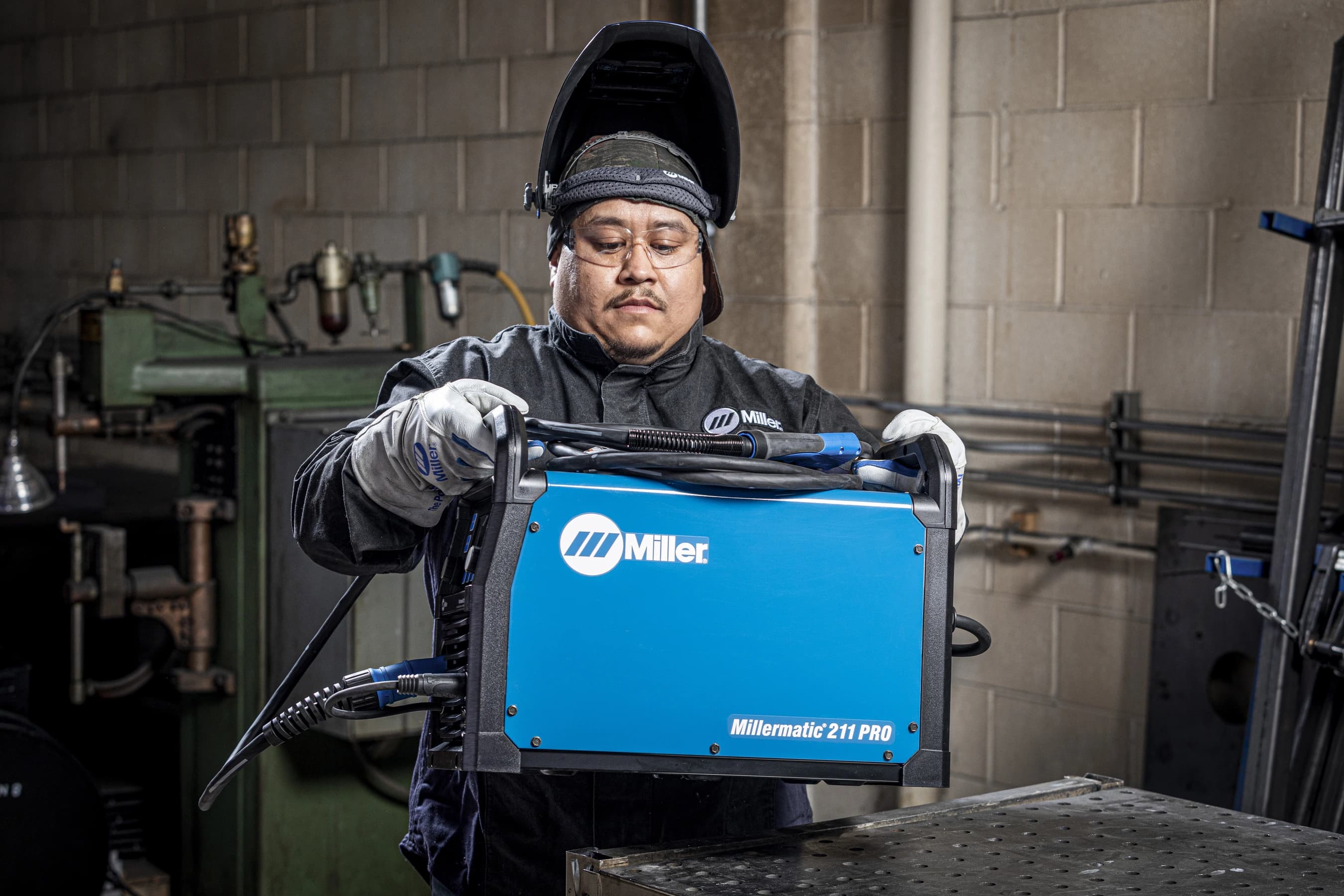

98% Argon/2% CO2: Best suited for the Millermatic 142 and Millermatic 211 PRO machines which have programming for it. A versatile option that can be used for spray transfer and pulsed spray transfer modes, this gas blend provides a good bead profile and wetting characteristics without the premium price point of helium. As with aluminum, it’s important to avoid introducing too much CO2 into the mix with stainless, as it can cause porosity or other weld defects.
