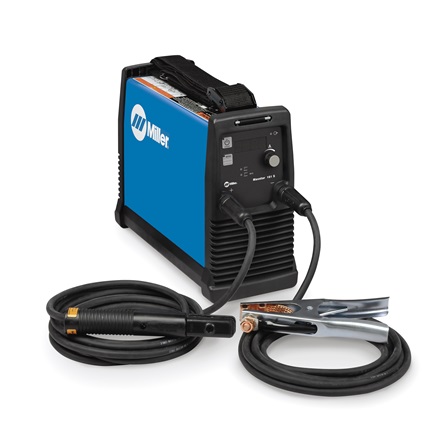

  • Maxstar® 161 S
  • 6.5 ft. (2 m.) primary cords for 120 V and 240 V
  • 13 ft. (4 m.) stick electrode holder with 25 mm. Dinse-style connector
  • 10 ft. (3 m.) work clamp with 25 mm. Dinse-stlye connector
  • Adjustable handle/shoulder strap
Compact Design Allows for Great Portability
Weighing in at 13 lbs. and featuring a convenient handle/shoulder strap, this little inverter-based machine can be taken from location to location.
