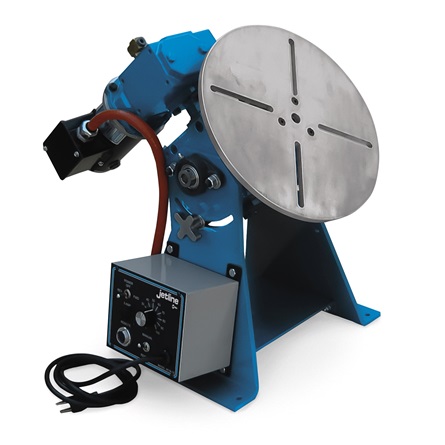

ZB-75ACA is designed for manual welding applications. RPM range is 0.5 to 7.5. Includes variable speed foot switch.
ZB-75DCA is designed for manual and automated welding applications. RPM range is 0.3 to 10 through a 1-turn potentiometer
ZB-75DCB is designed for manual and automated welding applications. RPM range is 0.1 to 3.2 through a 1-turn potentiometer
Specifications:
  • 75 lb. (34 kg) weight capacity with faceplate in the vertical position
  • 100 lb. (45 kg) weight capacity with faceplate in the horizontal position
  • 90 degree faceplate tilt from vertical to horizontal
  • 8 in. diameter aluminum faceplate with 4 tooling slots
  • High Frequency Protection
  • Forward and reverse toggle switch
  • RPM is set through a 1-turn potentiometer
  • 300 Amp ground
  • Weight: 28 lbs.
Options (sold separately)
  • 5 in., 3 jaw chuck
  • On/off corded foot switch for ZB-75DCA & ZB-75DCB only
