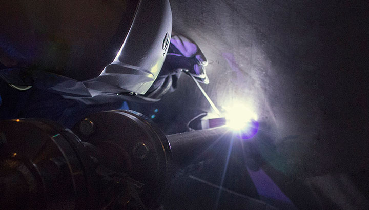

Closeup of TIG welding
A welder TIG welding
Polarity reversing for TIG and stick
When a pipe welding application requires going from a TIG (GTAW) root pass to subsequent stick (SMAW) welding passes, the need to change the welding polarity can add a lot of time and hassle to the process.
When welding carbon steel in field construction applications such as a pipe installation, TIG welding generally uses direct current electrode negative (DCEN), while stick welding and MIG (GMAW) welding processes typically use direct current electrode positive (DCEP). Welding with an incorrect polarity for the process can contribute to poor quality and result in weld defects that may require rework.
