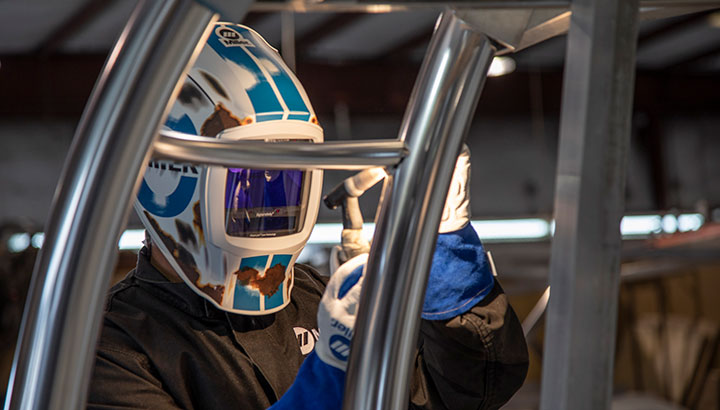

Challenges of welding anodized aluminum
TIG welding and fabrication in the aluminum division is mostly custom extrusions and pipes that range from schedule 40 to schedule 80, with wall thickness from .109 to .276 inch. G.G. Schmitt works with many types of aluminum round pipe, including no finish, mill finish and bright dip anodized (BDA).
Bright dip anodizing adds a special coating that enhances the glossy appearance of aluminum for cosmetic applications, resulting in a very reflective surface. To avoid scratching or damaging BDA aluminum during welding, operators often change their technique slightly to ensure the cups are farther off of the material surface.
“Welding anodized aluminum is a little bit more difficult,” Holl says. “It has to stay bright, with perfect finish and polish.”
If the welder “arcs out” or flares up it can cause spatter, which can leave marks on the surface of the BDA material. Any scratches or blemishes mean that leg must be cut out and replaced — without damaging other sections of the part. This rework process could take several hours and cost hundreds of dollars each time.
“It’s expensive,” Holl says. “You have to cut the leg out, replace it, then you can’t scratch what you’re cutting out on the rest of the product.”
