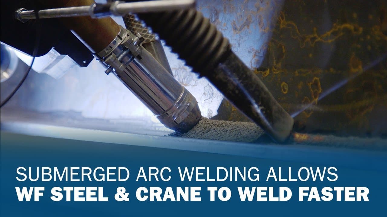

Submerged arc welding process on overhead crane box
Submerged arc welding gantry system for crane fabrication

The company converted to an automated gantry system with submerged arc welding (SAW), and it’s been a game-changer for productivity. In fact, they are now saving up to 15 hours on each large overhead crane build. The welding gantry is a twin wire, dual weld head system that includes two Miller® SubArc DC 1000 Digital power sources that use Hobart® filler metals.

The operator sits in front of the touchscreen and uses a joystick to position the two welding heads. The operator has dual independent torch control, with 84-inch servo vertical cross slides that allow for a range of automated weld seam tracking. They chose the touchscreen interface because it’s compact and user-friendly. A human hand must activate the override joystick for the system, adding an extra layer of safety in addition to making welding head adjustability easy for WF Steel’s operators. The gantry’s weld camera system also uses laser pointers, allowing the operator to view the weld location through the touchscreen monitor. Once the operator inputs welding parameters and guides the heads into place, welding begins.
“On the touchscreen everything is pre-set already, so I can basically just hit the start button and it's ready to go. It's very user-friendly,” says Corey Lewis, the system’s operator.
A horizontal and vertical track drive laser seam-tracking system that is servo motor controlled monitors the length of the joint, automatically adjusting for any curvature or arc in the beam. WF has welded beams up to 150 feet long with the system, which completes one continuous weld with twin wires on both sides simultaneously.
“The tracking is important because these box girders have camber in them, so a box this long will have 40-millimeter rise and back down,” Lewis says. “The laser tracking follows the camber in the box, so it will be a consistent bead the whole length of the girder. You wouldn’t have a very good weld if it didn’t follow that rise and keep the weld consistent.”
