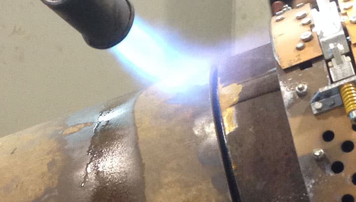

Many pipe welding applications rely on oxy-fuel or propane torches to bring the weld joint to temperature. This equipment can pose a problem in that most fuel gases are hydrocarbons. Thus, the process of igniting the torch and applying the flame actually introduces hydrogen into the weld joint. Heating with a torch also does not ensure uniform heating throughout the joint and HAZ, leading to cold areas that can heat and cool at uncontrolled rates.
Induction heating is recommended for optimal hydrogen diffusion and uniform heating throughout the part. Heat is induced in the part by placing it in an alternating magnetic field created by liquid- or air-cooled induction heating cables or blankets that are wrapped around or placed on the part, creating eddy currents inside the part to generate heat. Induction provides a fast time-to-temperature, offers safety benefits and delivers a strong return on investment compared to other heating methods. With induction, tools do not heat up and there is little noise and no toxic byproducts. In addition, operating costs are low compared to other methods. With flame heating, fuel costs can run up to $50 per hour and operations may have to pay fire-watch personnel*, while resistance heating requires installation of electrical infrastructure and often involves hiring third-party contractors who may charge up to $2,000 per joint.
Watch this video to learn more about how induction heating works and its many applications.
The key factor with induction heating is control. The operator controls the ramp-up speed, interpass temperature and post-weld soaking or stress relieving to exact parameters. This controls cooling and ensures the HAZ and weld retain the desired mechanical properties. At the same time, the control aids in the removal of diffusible hydrogen.
