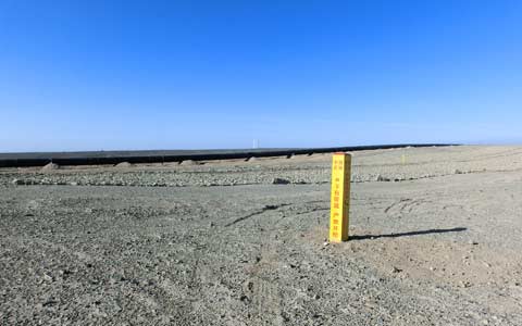

Such benefits were behind the decision to use API 5L Grade X80 steel for the Petro China (CNPC) WEST-EAST III pipeline project. This 7,378-kilometer pipeline crosses 17 provinces — from Xinjing to Fujian, China. It delivers 30 billion cubic feet of gas each year.

The Petro China (CNPC) WEST-EAST III pipeline project consists of API 5L Grade X80 pipe that is 1,219 millimeters in diameter, with wall thicknesses ranging from 18.4 to 33 millimeters.
