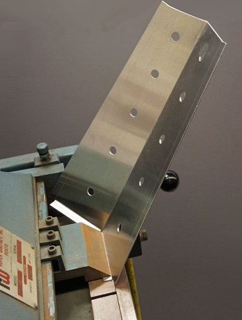

With the blanks for the tabletop laid out and cut to size, I can make pilot holes for the oval punch and flare dies. The bends are made first and the holes punched later — otherwise the bending brake would crush the flares around the holes. Here’s one edge of the tabletop after bending.
![Bending Brake forming a side rail for the table top](/-/media/miller-electric/images/images-for-articles/making-metal-article-series/2018-2019/article-7-ron-covell/end-table-photo-01.jpg?h=449&w=350)

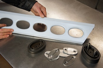

With the profile bent on all four sides of the tabletop, the 2 by 3-1/4-inch oval holes can be punched using an H-frame press. You can see the male and female parts of the dies and the slugs that were punched from the holes.
![Oval holes being punched](/-/media/miller-electric/images/images-for-articles/making-metal-article-series/2018-2019/article-7-ron-covell/end-table-photo-02.jpg?h=229&w=350)

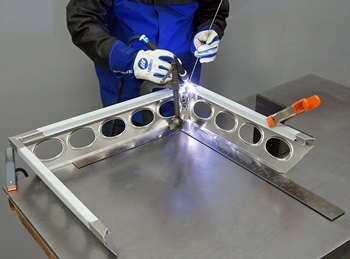

Now the mitered corners for the tabletop can be jigged up and welded together. I’m using my welding table to align the edges of each component, and a carpenter’s square to check the angle at each corner. The corners are tack welded, then everything is double-checked before finish welding.
![Jigging and tacking the corners of table top](/-/media/miller-electric/images/images-for-articles/making-metal-article-series/2018-2019/article-7-ron-covell/end-table-photo-03.jpg?h=259&w=350)

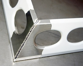

Once I’m satisfied with the alignment, the joints can be finish welded. I select “TIG Aluminum” from the control panel menu, and, using the Auto-Set™ Elite feature, I select my 3/32-inch tungsten diameter and the 16-gauge material thickness, which automatically sets the machine to 95 amps. I use 2 percent ceriated tungsten (color coded grey) for just about all my welding, ground to a sharp point. I’m using 1100 alloy filler rod, 1/16-inch diameter. The Multimatic 220 machine gives me great control and lays down a beautiful weld.
![Corner, finish welded](/-/media/miller-electric/images/images-for-articles/making-metal-article-series/2018-2019/article-7-ron-covell/end-table-photo-04.jpg?h=276&w=350)
After the welds are completed, I use a hand-held sander with 100-grit abrasive to remove the bulk of the weld and then sand each joint with progressively finer abrasives to blend the joint in with the mill finish.
![Finishing mitered corner](/-/media/miller-electric/images/images-for-articles/making-metal-article-series/2018-2019/article-7-ron-covell/end-table-photo-05.jpg?h=290&w=350)

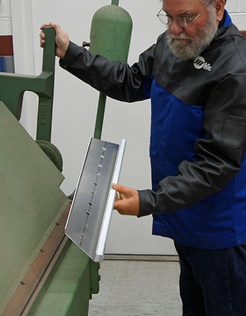

Next, I’ll make the legs. As before, the blanks are cut, and the location of the holes for the punch and flare dies are marked and drilled. I used a box and pan brake to make the small flanges on the top of each leg. The long bends are made in the leaf brake.
![Box and pan brake making small flanges](/-/media/miller-electric/images/images-for-articles/making-metal-article-series/2018-2019/article-7-ron-covell/end-table-photo-06.jpg?h=463&w=350)

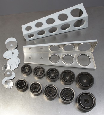

I’m using five sizes of holes for each leg — starting with 1-1/4 inch and graduating up to 2-1/2 inches.
![Holes being punched and flared](/-/media/miller-electric/images/images-for-articles/making-metal-article-series/2018-2019/article-7-ron-covell/end-table-photo-07.jpg?h=389&w=350)

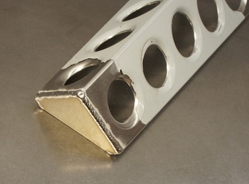

After the holes are punched and flared, I cap the bottom corner of each leg to finish it. I’m using 1/8-inch-thick aluminum for the caps.
![Cap welded onto table leg](/-/media/miller-electric/images/images-for-articles/making-metal-article-series/2018-2019/article-7-ron-covell/end-table-photo-08.jpg?h=260&w=350)

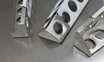

After each welding joint is sanded flat and the surface finish is blended, I use several grades of abrasives to get the final finish.
![Smoothed cap on table leg](/-/media/miller-electric/images/images-for-articles/making-metal-article-series/2018-2019/article-7-ron-covell/end-table-photo-09.jpg?h=207&w=350)

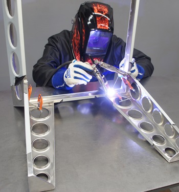

Now I can join the table legs to the top. My design places the welds on the inner edge of the flanges, so no weld cleanup is needed in the valley between the leg and the top. This will make a crisp, clean joint.
To make a good edge weld, it's very important that the metal is squeaky clean and the parts need to be clamped tightly together. I did my best to keep the tungsten perpendicular to the edge — although this was challenging because of the confines I was working in.
![Welding leg to table top](/-/media/miller-electric/images/images-for-articles/making-metal-article-series/2018-2019/article-7-ron-covell/end-table-photo-10.jpg?h=375&w=350)

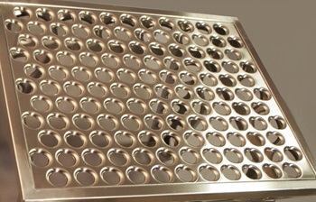

I originally planned to use a piece of glass for the tabletop, but once I reached this point, I hatched the idea of incorporating a sheet of metal perforated with more holes. I think this adds a nice touch to the table design, and placing a sheet of glass over the holes will provide a smooth surface and prevent small objects from falling through.
![Table top insert, with holes](/-/media/miller-electric/images/images-for-articles/making-metal-article-series/2018-2019/article-7-ron-covell/end-table-photo-11.jpg?h=224&w=350)
Here’s the completed table, and I’m absolutely thrilled with the end result. This table will fit at the end of a sofa, and I look forward to making a larger coffee table with a similar theme.
