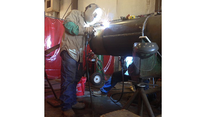

The company converted from stick welding to advanced wire processes for some of its pipeline repair and tie-ins. They used pulsed MIG and Regulated Metal Deposition (RMD®) processes with XMT® 350 FieldPro™ power sources and Smart Feeders.
In a modified short-circuit MIG process such as RMD, the welding system anticipates and controls the short circuit, then reduces the welding current to create a consistent metal transfer. Precisely controlled metal transfer provides uniform droplet deposition, making it easier for the welding operator to control the puddle. Advanced welding processes such as pulsed MIG or modified short-circuit MIG are also more forgiving to variations in stickout and result in a calm stable arc, which makes it easier for operators to control.
